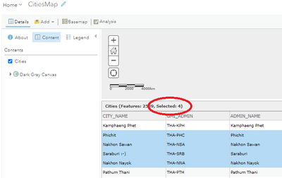

In ArcGIS Online's Attribute Table the Selected count is shown here. Or do you mean something else ?

they asked about experience builder, not map viewer classic...
