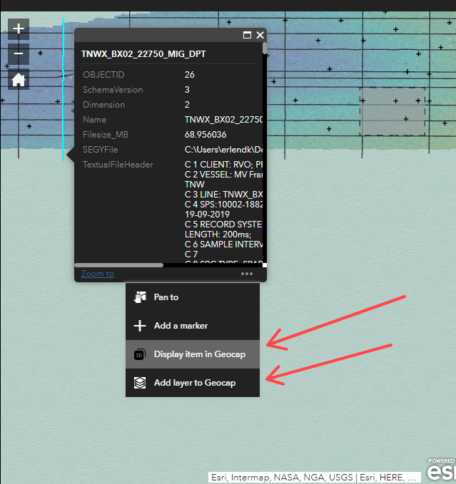

Hello,
It came time to switch from WebAppBuilder to Experience Builder and I have a question regarding it. In Wab, it is possible to implement featureActions defined in manifest.json as an array of objects(name, URI) and those actions are visible in the pop-up's menu (...) of each, single, clicked element in the map.
How can I implement the same type of actions in Experience Builder?
I tried to use Experience Builder's dataActions defined in manifest.json as well, but these custom actions are only visible in "Table" widget. I would like to avoid using Table as an extra widget.

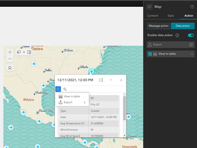

TonghuiMing
In the latest AGOL October release, the Map widget provides the data action within the pop-up, so it might be helpful to utilize that as well:
