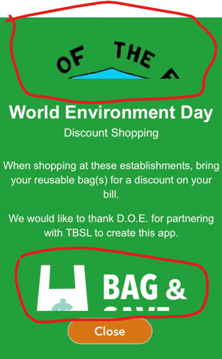

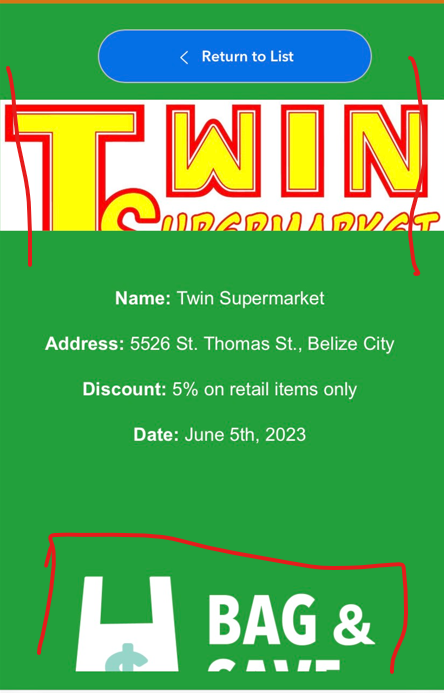

 I recently created an app using Experience Builder and when I view it on mobile devices something is strange.
This is how it displays on my friend's iPhone XR

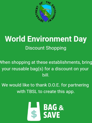

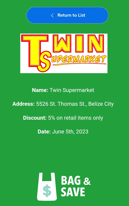

and this is how it looks in my Samsung Galaxy A10s
I also tested in another Samsung Galaxy A51 and it also shows the full images.
I don't understand this is happening because I set the position for all the image widgets to "Fit"
Is there a setting I'm missing in Experience Builder to have the images in the image widgets fit all mobile devices? or is there a general issue with ArcGIS Experience Builder and IOS devices?
