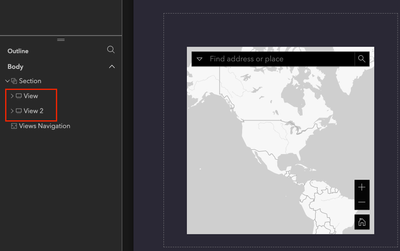

Thanks for the feedback. This is a known issue which we have been working on. It will be fixed in the next release. Now you can make views autoplay by changing the app URL as a walkaround:
  • Go to the TOC, check the names of the views in the Section widget (for example, in my app the first view name is View, the second view name is View-2)
  • Save your app, go to Preview, or visit the link if it is a published item. Now the contents of the first view (View) are displayed

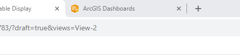

  • Go to your app URL and append the following:
    • ?views=View-2 (in published link)
    • &views=View-2 (in preview)
  • This will result in switching the app to View-2. Then, you can see the autoplay works as expected.
