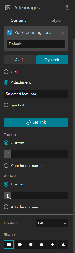

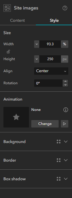

I am building an app using experience builder and have come across an issue only in tablet and mobile screen sizes. I have an image widget that populates with the attachments from my map data. The image size is fixed, so I have the "fill" setting on so the attached images fill the space. On desktop, the images vertically align center, which is what I want. For whatever reason, on tablet- and mobile-size screens, the images are top-aligned in the image widget. I can't find a vertical alignment setting for the image, only a horizontal alignment setting for the whole widget, not the image that populates it.
Current image widget settings:
MackenzieCope_0-1657061031744.pngMackenzieCope_0-1657061031744.pngMackenzieCope_1-1657061051264.pngMackenzieCope_1-1657061051264.png

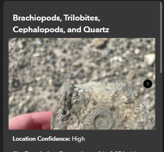

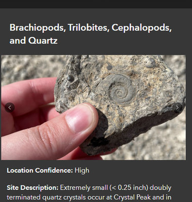

Desktop vs Tablet image output:
MackenzieCope_2-1657061118168.pngMackenzieCope_2-1657061118168.png   MackenzieCope_3-1657061166357.pngMackenzieCope_3-1657061166357.png
Has anyone else run into this and have ideas? I really don't want to go through all my data attachments and have to resize them manually. I would just like the "fill" setting to fill the widget but align center. Thanks!
