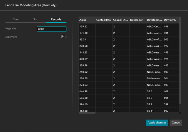

In the Data panel for your feature layer, you can change the data settings to increase the record page size for the data. By default, it is set at 100.
You should be able to increase it to match the service max record count (2,000 by default)

I found this option and first off, that is not very intuitive to call this "Page Size" and have it located under the settings hidden deep in the data panel for a layer. Second, I changed the max to 10,000 and though it allowed and accepted this number, it still will not let me select anything more than 1980 in my map. This is a very frustrating limitation. Most agencies have more than 2000 assets; counties have more than 2000 parcels, road departments typically have more than 2000 road segments, counties and municipalities that utilize GIS typically have more than 2000 address points unless they are very small. This limit does not fit with the actual needs of GIS users.
