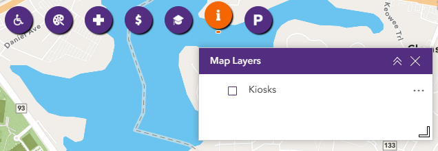

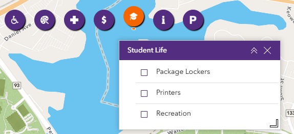

Hi MauryT. I found this thread looking for I think the same thing; I am using a widget controller that contains several Map Layer widgets. Each ML widget is customized to show only related layers. For example, I have a ML widget for toggling different classifications of building polygons on and off. Same for parking, public safety, etc. However, I have a few layers that don't fall into a category--they're standalone. I need a button in the widget controller that, instead of showing a Map Layer widget that contains just a single layer, simply turns that layer on and off upon clicking the button. Otherwise, I'm asking the user to click twice to turn the layer on.
To show you what I mean, this is desired behavior, a Map Layer widget that shows specific layers that are related.
This is case, I have a single layer. Instead of opening a layer-list, I want the button to simply turn the visibility on and off. As is, using the Map Layer widget amounts to asking the user to click multiple times--once to open the layer-list, and another to click the lone layer present.

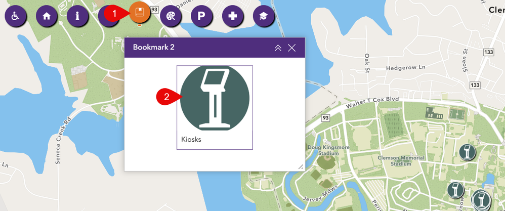

I've added a bookmark widget to the Widget Controller. I've configured the bookmark widget to show a single layer. I don't want the zoom extents to change, but instead just behave like the Map Layers widget that toggles layers on and off by clicking the tick box. This is what I encounter.
1. After adding the Bookmarks Widget to the Widget Controller and configuring it to custom display only one layer, clicking the widget causes the Bookmarks Widget window to appear.
2. A second click is needed to display the layer data.
Clicking on the bookmark again does not hide the layer, so I'm missing something there?

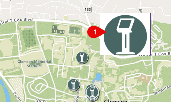

Here's an example of adding the Bookmarks Widget straight to the map.
1. This time clicking the Bookmarks Widget causes the layer data to appear without having to reveal the widget in the Widget Controller.
Once displayed, I cannot get the layer to turn off by clicking the Bookmark again.
