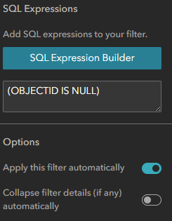

  1. Filters are a workaround, but if you enable all of the layers, then filter them invisible, it sacrifices a lot of performance and seams pointless.
    How to:  Layers in question should be loaded on start (e.g. toggled ON). Then Filter widget can be styled like a button with a custom icon and all. You should add reverse SQL expression --> like asking to filter for something that's not there. I use this: (OBJECTID IS NULL)
    Finally, make sure to toggle "Apply this filter automatically" for it to be applied on load.
