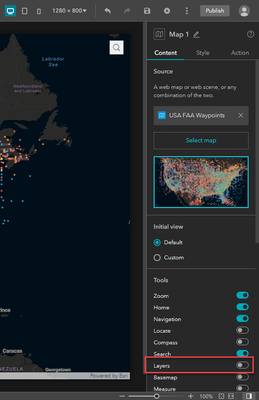

GavinRehkemper
Hi, when adding the map widget to your Experience, there is an option to enable the "Layers" tool which will allow the end user of the app to toggle visibility of layers.

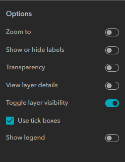

MargrietdePender
After adding the layers widget to the map you can activate the option Toggle layer visibility.
With that option you can also activate the new option Use tick boxes:

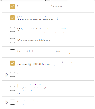

Then users get on or off switches per layer:
This is much understandable for the users.

MargrietdePender
Im not sure if the question is still active, but you can add the Widget Map Layers.
You can connect this Widget to Interact with the map widget (choose the correct one).
It also has an option 'Toggle layer visibility' if you switch it on, you have an additional option to use tick boxes.
Now you users of the app can easily switch layers on and/or off.
