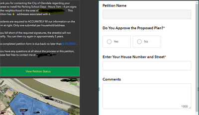

MatthewCayuela
Up until today I was able to pass polygon location data from a map into a survey in Survey 123 in Experience Builder. Now when I go to pass the *Shape(Polygon) data it sends over this skinny polygon in the middle of nowhere.  You can see on the map the parcel I am selecting and on the left you can see the narrow polygon that it is pulling over. The other text and number data fields transfer over fine.
I tried to troubleshoot this thinking it was an issue with the layer.
  1. I tried a different parcel
  2. I removed and re-added the field/question connections
  3. I tried pulling from a different polygon layer
  4. Tried a different browser
  5. I created a brand new test survey and brand new test experience with a different layer.
All results still coming up with the same bug.

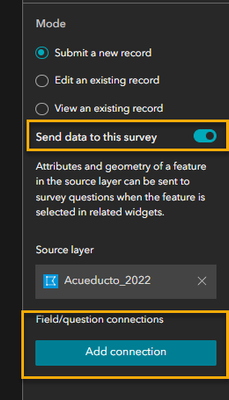

cepsgis
We are having a similar issue, but its with the data coming from the feature itself. None of the fields are being pulled over into the survey. Is there something I may be doing wrong?
Ruth_JiatengXu
Hi @cepsgis,
Thanks for sharing your question. Could you please help double-check the settings of your survey widget?
1. Which mode are you using for the survey?
2. If you are using the submit a new record, please also check:
  • Have you enabled to send data to this survey?
  • Have you added the connection between the source layer and the survey?
3. If you are using edit or view an existing record, please let us know I will help you investigate further
