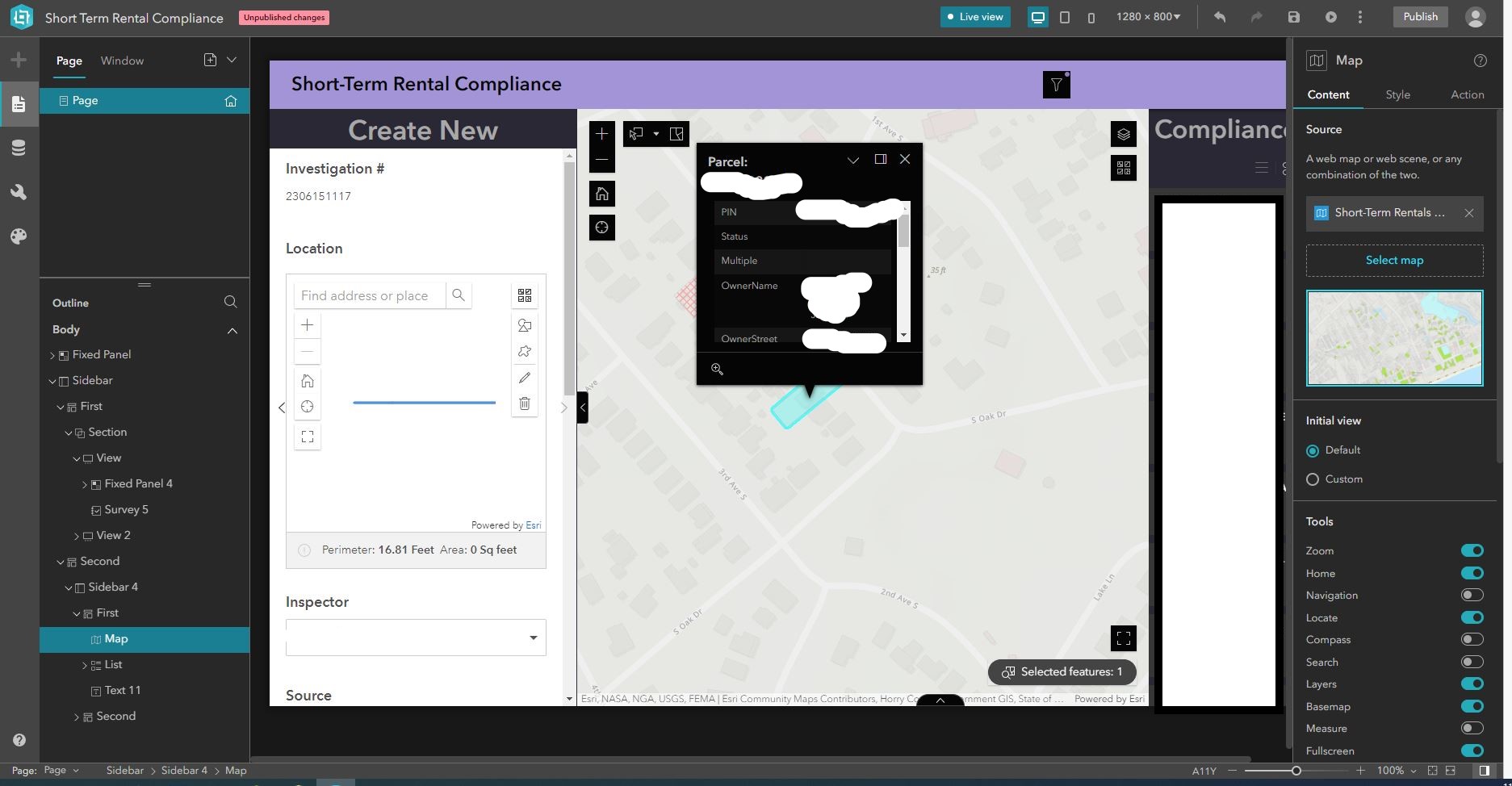

Up until today I was able to pass polygon location data from a map into a survey in Survey 123 in Experience Builder. Now when I go to pass the *Shape(Polygon) data it sends over this skinny polygon in the middle of nowhere.  You can see on the map the parcel I am selecting and on the left you can see the narrow polygon that it is pulling over. The other text and number data fields transfer over fine.
I tried to troubleshoot this thinking it was an issue with the layer.
  1. I tried a different parcel
  2. I removed and re-added the field/question connections
  3. I tried pulling from a different polygon layer
  4. Tried a different browser
  5. I created a brand new test survey and brand new test experience with a different layer.
All results still coming up with the same bug.
