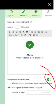

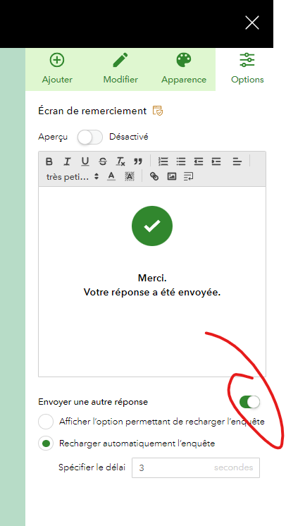

I've seen that we can set this auto-refresh behavior in surveys created on the web:
But is there a way to edit this behaviour in Survey123 Connect ?

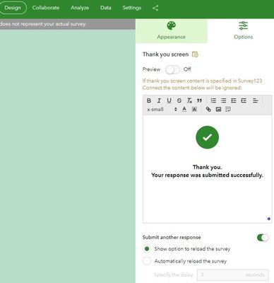

Hi @Lodry This is setting is still possible to configure for surveys published from Connect. Just access the Design Tab via the same manner via  https://survey123.arcgis.com for your survey published for Connect. Less options will be visible but the Thank You Screen is accessible.
Let me know if this help
