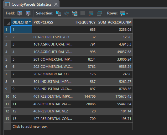

Is there a way to implement summary statistic tool in ExB? I just want to summarized the area field by grouping the property types.

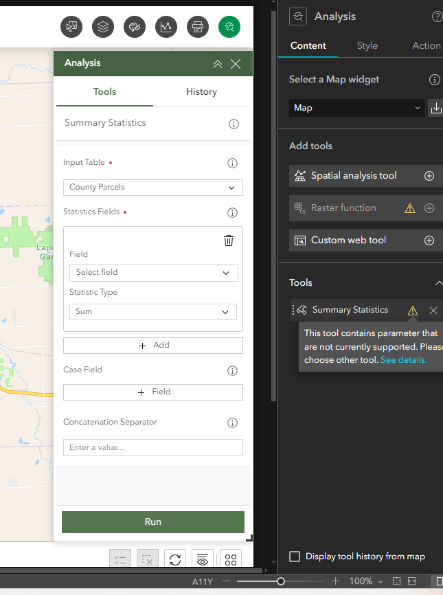

It can easily be done in ArcGIS pro(see screenshot below). I published the GP tool and added to ExB via Analysis tool, but was presented with the warning "this tool contains parameters that are not currently supported"
Does anyone have knowledge is the Summary Statistics tool will be supported in ExB anytime soon?
