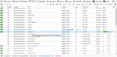

Start by exploring the network traffic to see how much time it's taking to get all of the items. At a quick first glance, it's taking 35 seconds to download the config.json file. That's a very big file, containing many layouts and widgets.

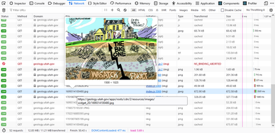

Look at the images that are getting added. It's taking three seconds to download one image. Do you really need an image to be that size? Instead, use a thumbnail with a link to the full-sized image.
