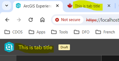

I know we can set the browser title for the app in the builder as shown in the screenshot above, but I want to be able to set different titles for different pages and would like to avoid creating a separate app for each page.

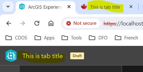

Yuriko
We were able to override the 'document.title' property from reverting to the default 'page title| app title' by modifying the '\dist\cdn\0\jimu-core\index.js' file in the downloaded app.   As we have a separate custom widget that sets the 'document.title' property in an app page to a desired value, we set the variable "document.title" from 'r' to 'our desired value.
