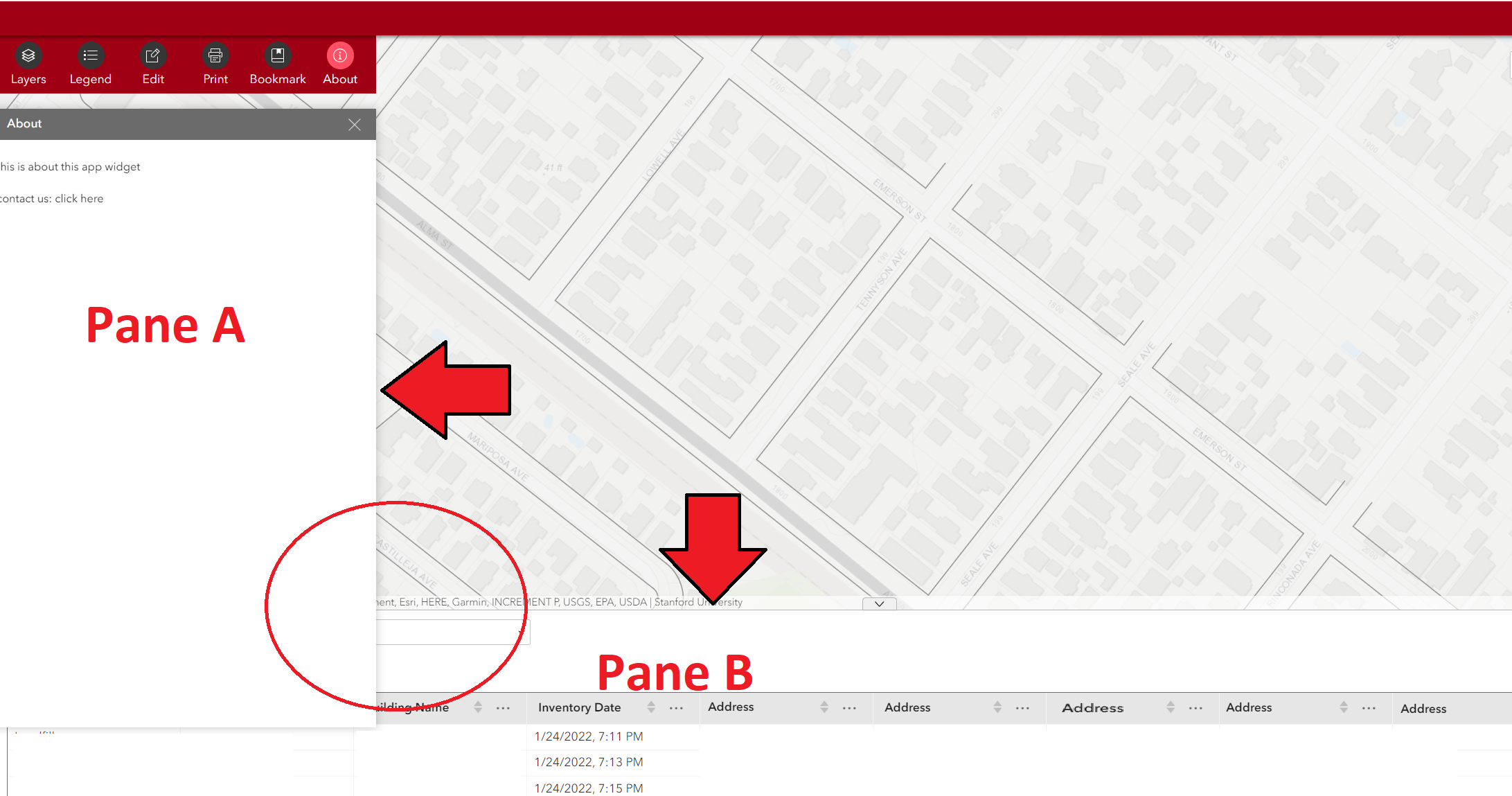

Hello all,
I have set up a project with a sidebar containing the First (left) and Second (bottom) windows. Currently, if I have Pane A opened and then click to show the bottom table, the bottom pane is placed below Pane A.
Is it possible that when I open Pane B, Pane A will collapse/minimize, and vice versa?
thanks!!!
W
JeffreyThompson2
MVP Frequent Contributor
Auto-closing/opening a sidebar is not an option in Online/Enterprise versions. In Developer Edition, use the following code.

WilsonLee
thanks for the info : )
