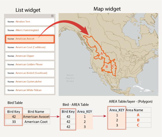

Hello Community,
Does anyone know if is possible to use any of the AGOL applications to build an app like the image below? It is  just a very simple selection of an element on a list  to highlight the related polygons on a map.  I have been trying to use Dashboard and Exp. Builder to build this workflow but both apps are not capable to display the related data. Before I look outside AGOL  (MS Power BI) to build this, I wanted to be sure that is not something that I'm missing!. Thanks for any suggestions or ideas.

Hi @JoseBarrios1 ,
In the latest AGOL update, you can add the message action Record Selection Changes - Map - Flash to the list widget. Trigger/action connections should by default be set to use layer's relationship.
