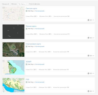

The settings of the group and all base maps are already set as global

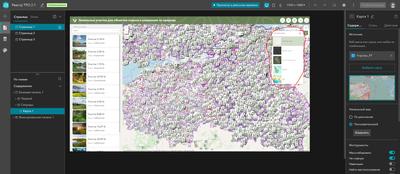

Settings of ExB app global too.
When we use the preview in ExB, local maps are displayed in the basemap list, but when the application is published there is a standard list

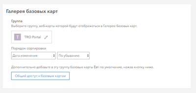

Go to your organization settings, under the "Map" section, change the Basemap gallery group.  This should change which basemap is used when creating web applications.  Not sure if it will update in your current web application.  Maybe try a new one to test after you change the settings?

The problem is that local basemaps work only for authorized users, and if you open app globally without authorization in list avelibale only standart basemaps.
