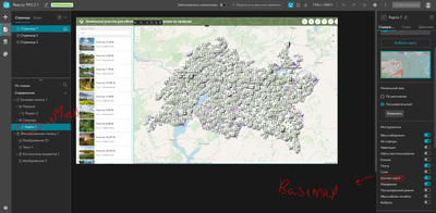

Experiece Builder. Try to publish any app and open it with incognito mode on yur browser. GeorgeKhristoforov_0-1634836225038.png

I see all standart basemaps on this list.
