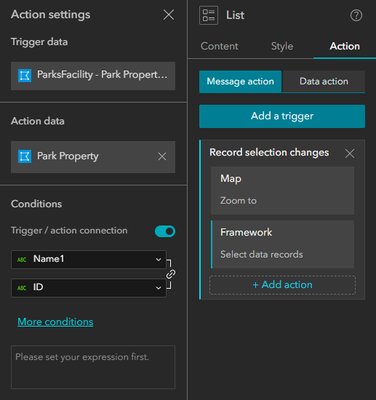

As I understand your problem you have two lists connected to two separate feature layers that share a column of related data and you want to select List1 and have List2 filter. You should be able to do this with a message action.
  1. Select the Action tab in List1 > Message Action > Record Selection Changes > Framework. (In my example, List1 is ParksFacitlity - Park Property.)
  2. Set the Action data to the data List2 is based on. (Park Property in this example.)
  3. Set the trigger/action connection to the shared column. (List1 values in Name1 will filter matching values in ID of List2.)

Oh it's great ! that's what  I need ! big thanks
It is possible to make the same things, but with multiple data source or it's limited to 2 data sources ?
To return to my previous exemple : I select one society on my List (Source1), it select/filter the building where the society is on my Map Widget (Source 2) and the application select in a Table Widget the information of Transaction (Source 3). It is possible to do that ?
JeffreyThompson2
MVP Frequent Contributor
You can trigger multiple framework actions off of the same event, so this should be possible as well.

Ok ! thanks, you solve my problem 🙂
