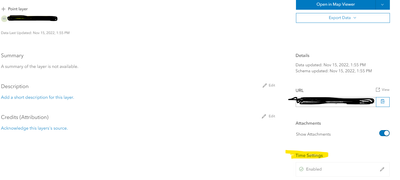

The timeline widget was the one to use, but when I first tried to use it, there was no data to select. Turns out that I had to go into each layer and enable the Time Settings
Once I'd done that in each of the layers I wanted to filter, I was able to add each layer to the widget and could then filter all the elements from the timeline.
rogue_recon
I have a similar goal and my layers have the date and time in the attributes, but I am not seeing that enable feature you posted. Have any idea where else I can look?
