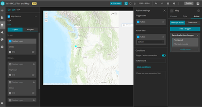

You could add a message action to the Map widget.
Record selection changes -> Framework -> Filter data records, set Trigger and Action data.
Please refer to the sample app: https://experience.arcgis.com/builder/?id=101c4e2a26c349be805f7e11cc4dd65e&views=data
Thanks,
Ke
Leonidas
Hi Ke,
Thanks for sending this.  This is how I had my app set up.
I played around with the webmap and how the layers were added and got it to work that way.  The layer was originally linked to by using a portal map with a few other layers in the map service.  The layer was burred in a layer group.  When I linked directly to the layer in the service by using its ID (in portal webmap), selection on map click worked.  Hopefully that makes sense.
My issue now is that I would like to not show the ! icon when nothing is selected in the List and just the 'Click on a Parcel' text.  Is there any way to do this?
