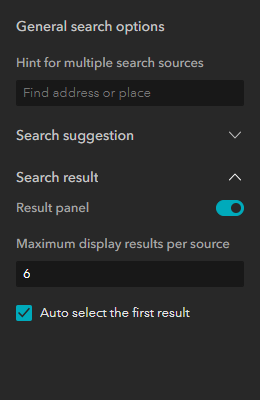

Problem 1 is an easy fix. In the builder mode, open up the search result options and check 'Auto Select First Result'.
Problem 2 is some bad design on ESRI's part. I have a fix if you are using developer edition. Open the result-list.tsx, find the onSelectRecord function and add onShowResultButtonclick()

In the picture above there is a toggle switch to turn off the Result Panel, as of the latest version of ArcGIS Online, this option actually works and you can use the Search Widget with the Results Panel turned off. This should be in Developer Edition 1.16 in a week or two.
