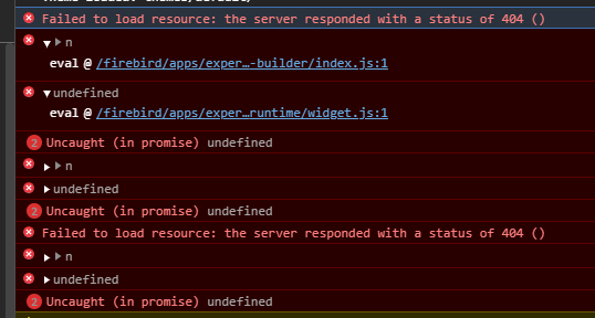

I am using Experience Builder on ArcGIS Enterprise 10.8.1. I'm trying to add a new map to my experience which uses 2 secured services from my 10.7.1 GIS and Image Server. I'm getting a vague 'Saving Error' message when I try to save my experience after adding the map.
I have 2 services, 1 Map Image Layer and 1 Image Service coming from my 10.7.1 GIS and Image Server - both are shared to my organization.
I added both services to my 10.8.1 Portal and saved credentials with the service. Then, created a map which works just fine in the map viewer. I can see both services there.
In experience builder,  I created a new page with a map and added the map. When I do this, I am unable to save the experience builder. Is there anything obvious I am missing or can check? The webmap works fine in the 10.8.1 Portal Map Viewer but when I try to add it to my Experience I get a 'Saving Error' message. This is what I see in DevTools in my browser:
Devtools errorDevtools error
