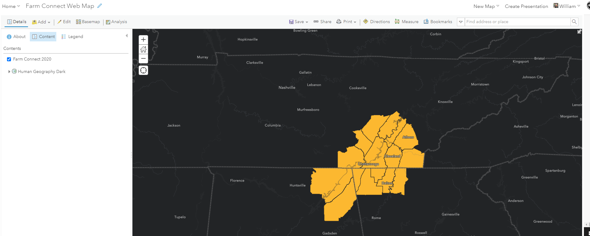

  • STEP ONE: First, I created a web map called the Farm Connect web map (seen in the image below) with the geometry of the 16 counties.

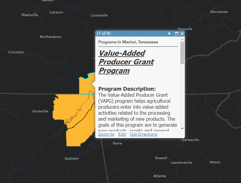

  • STEP THREE: Next, using the "Make Query Table" geoprocessing tool,  I created the one to many relationship. In the image below, you can see proof of this. Here, I can click on 1 county, and 8 unique program records show up in a pop-up. So, we see that there are 8 programs in that county a user can explore. This worked great. (Aside from some serious problems with the "Make Query Table" tool - ESRI, you guys should really get that tool fixed. It would crash pro every time I ran it. FYI, to fix it, I saved just before running the tool, restarted my computer, ran the tool, and it worked.)

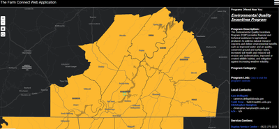

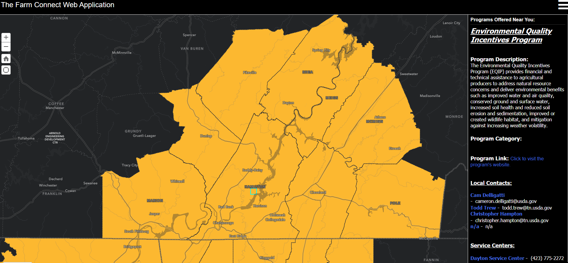

  • STEP FOUR: Next, I created a web app using web app builder. This web app was originally going to be the end product. It functions flawlessly. A user can click on one of 16 counties, and a list of programs offered in that county populates the screen as a scrollable list on the right side of the screen, seen below in an image.

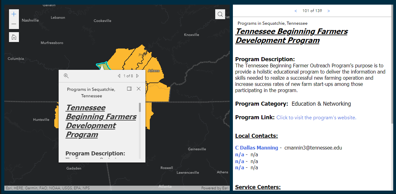

  • After adding the farm connect web map to the experience, I tried adding a widget that would show the selected programs offered in that county, which would be triggered by a user clicking on a county in the map. (Literally the same function as the first version of the web app in STEP 4.) I tried using the feature info widget. However, instead of a complete list of the programs offered in that county, the feature info widget just shows just the first occurrence of a program with the selected county name, and not a list of all the programs specific to that county.   In the picture below, you can see that the pop-up has found eight unique programs for that county, so the one-to-many relationship is still there thank lord.

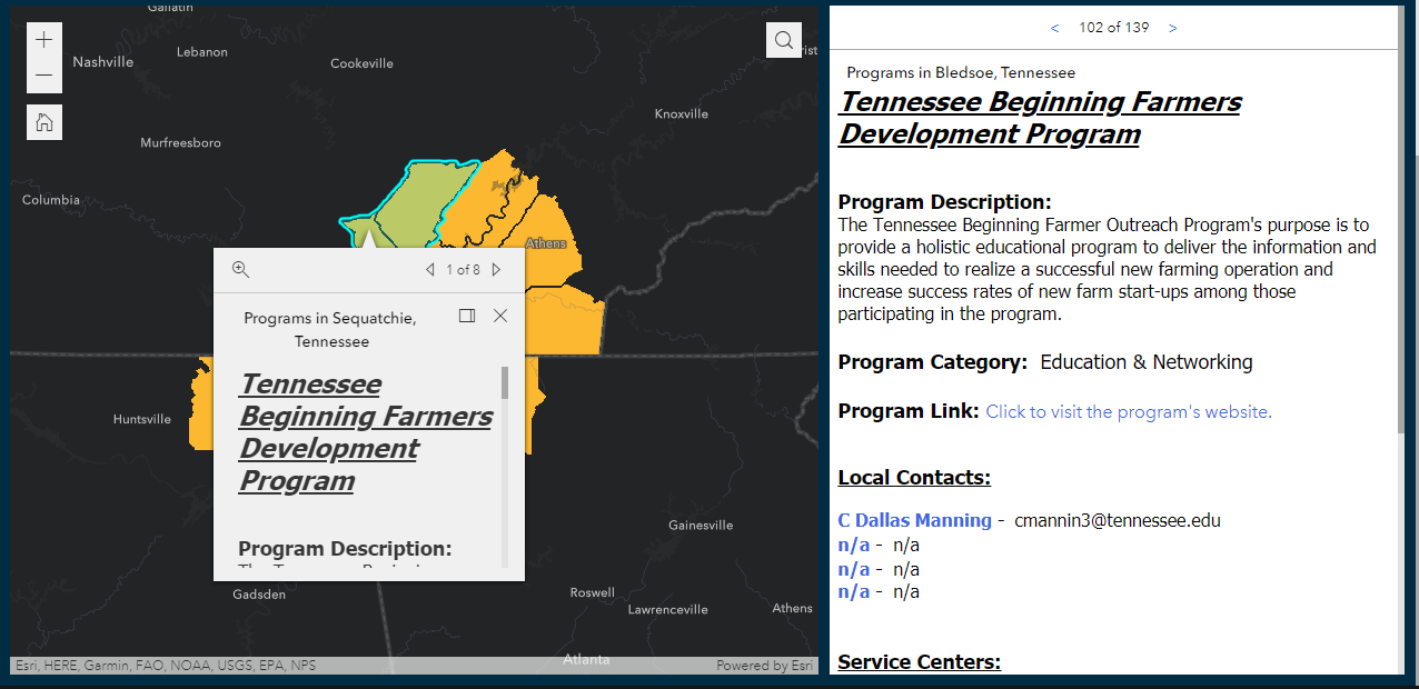

  • However, when I click the "next" arrow in the feature info widget (moving from record 101 to record 102), you can see the problem. The feature info widget should find the next program in that county, matching the next consecutive pop up record, but instead it selects the next consecutive record in the complete data set (which happens to be the same program but for a different county). See the picture below for this proof.

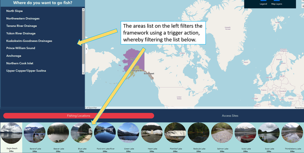

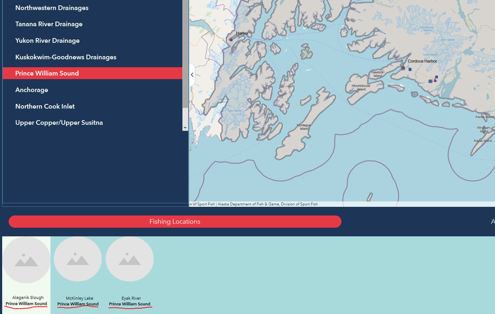

You can do this with two Lists an a trigger action set on the first List. The first List would be your counties, and your second list would be the associated programs. You would set up a trigger on the counties List to filter the framework, including the associated programs List, based on a key field between the two tables (this does make the Query Table moot for the Experience Builder). I have a similar set up to handle a few one-to-many cases between feature services with one of my Experience Builder pages. See the result of this pictured below:
First list selection applied, with the result in the second list:
Hope that's helpful!
