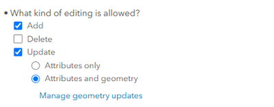

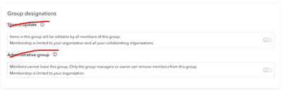

Thanks for the follow-up. I opened a ticket with Esri support, and we figured out the issue. I was not aware that users within non-shared update groups could still update and edit content. When I restructured my groups to NOT be shared update groups, the editing settings I put in the experience and web feature layer were honored - the delete option was removed from the edit window. I learned that shared update groups give members privileges similar to admins and they can update and delete the data regardless of the settings in the web feature layer or the Experience.

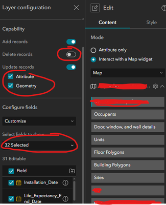

@RVRAdmin @HannahWilson3 The content I'm sharing and which I want users to be able to update some parts of, is only shared at the owner level in most cases. I learned that to remove the option to delete features but keep some editing capabilities the group needs to not be shared update, the web feature layer needs to have the "delete" option deselected from the kind of editing allowed, and the layers within the edit widget in the Experience Builder need to be/can be further tailored down to the attribute. Hope that helps your situation.
