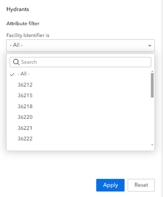

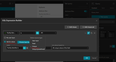

1. Select your field and set the source type to 'Unique'. Then, choose the 'Ask for value' option.

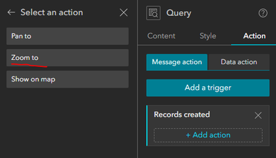

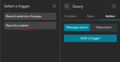

2. Configure the "Records created" -> Map "Zoom to" message action
This will create the intended Query widget, allowing end users to select a value from the unique value list and then zoom to the query results.

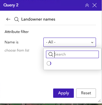

Hi, I am facing a problem while trying to apply query like this. I have the query widget with the condition set, but the dropdown menu is not visible, it is showing only loading, not displaying the list of values for the user to choose from.
LakshmiRajeevKumar
I found the issue that the layers, when publishing, need to be in gdb; otherwise, it will be published without advanced query capabilities like orderBy, Distinct etc,. Now, once all the required layers are published from gdb, the query works perfectly.
