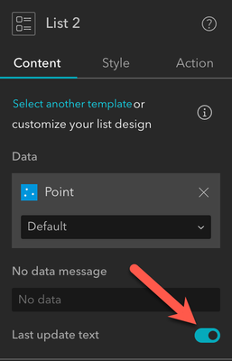

Hi, you can set the interval from the Data panel - layer settings:
After turning the Auto-refresh on, you can see the switch Last update text in the list widget settings.

Arueira
Infelizmente, somente para o widget Lista!
