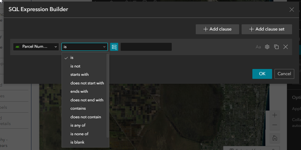

I have a parcels layer and a table widget in EB developers ed 1.12 (latest release).  I have 10-digit parcel numbers and 17-digit parcel numbers, but they are in the attribute table as strings.  I need to filter out all 10-digit parcel numbers, but the filter widget does not allow for writing your own SQL statement (this would be a very simple task if it would). When I use the "build sql expression" tool for parcel number my choices are:
(the last choice not see is "is not blank.")
Does anyone know a way to filter out these nearly 2800 10-digit parcel numbers without entering them one-by-one?

Try Contains _________________
That is 17 underscore characters. Underscore is the single character wildcard in SQL.

AngelaSchirck
Perfect! Thanks!
