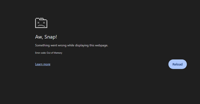

This post pertains to Experience Builder on ArcGIS Enterprise (11.2) and ArcGIS Experience Builder Developer Edition 1.15.
I have 6 dashboards that are hosted on ArcGIS Portal. In both versions of EB, I have 6 pages, one for each dashboard which contains the Menu and Embed widgets. The Menu widget links to each dashboard, and the Embed widget is the URL from each dashboard on Portal. After using the Experience for a minute or so and switching between various pages on the Menu widget, an error will appear in both Chrome and Edge causing the application to crash. Has anybody had this issue of embedding multiple dashboards and having the browser crash during use? The console logs on browsers did not yield anyresults, and I have exhausted a support case with Ersi on this.

Chrome and Edge are very memory hungry applications. Experience Builder and Dashboards can also be a memory hog. Even more so, if you are using live updating data. I thought you ran out of memory even before I saw the error code.

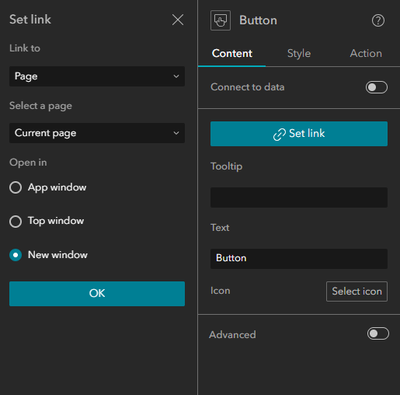

A couple ideas that might make this design viable.
  • If you are using Sections, try the Lazy Loading option. This should delay loading a View until it is actually needed.
  • If you are using Pages, try opening the Page in a New Window. This should spread the memory load over separate tabs and make it easier for Chrome to manage. JeffreyThompson2_1-1731525256900.png

This morning, I tried a different approach by adding the 6 dashboards to a new Hub site. The dashboard will open in a new tab from the Hub site, but the same results. It seems to be the consensus here that a browser memory issue causes the crash.
