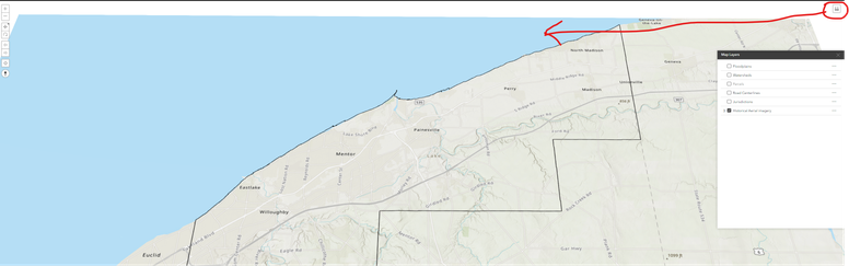

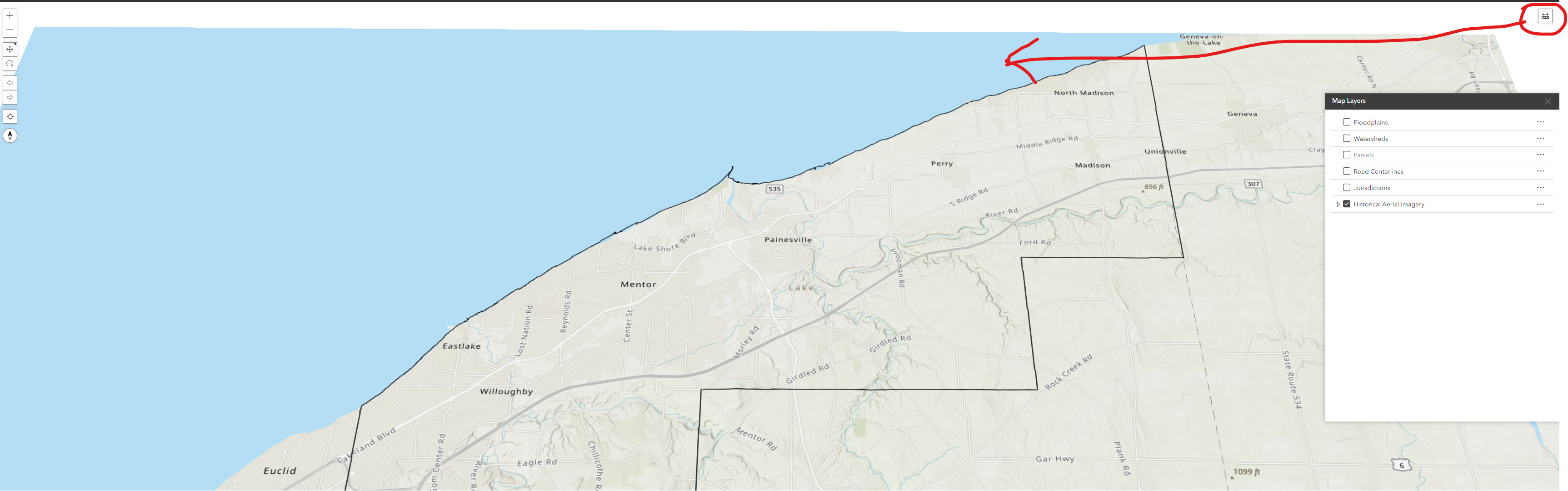

Is there anyway to move the tools in the map widget in experience builder. I am creating a 3D map and would like to have the measurement tool enabled and bunched up with the other tools, but it is put in the top right corner of the map and i cannot move the tool. There is no measurement tool widget so i cannot create a custom button or widget controller for it. I have seen there is a custom measurement tool widget, but i am using a 3d map and that only works for 2d maps.
Look how far away it is from the other tools. It's lonely 😞

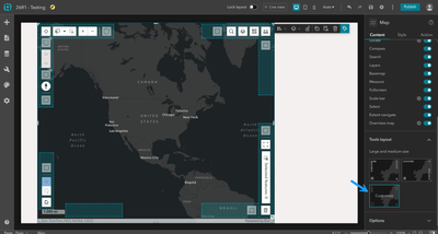

Hi All,
This feature will be released on ArcGIS Online in February 2026.
Steps:
1. In Map settings, go to "Tools Layout" and click "Customize".
2. Drag map tools to any of the four corners.
3. For the Overview map tool, go to Map widget settings, open "Overview map settings", and select the position.
Note: This feature is only available in full mode on medium and large devices.
