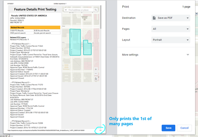

In the off chance someone else may have experienced something similar, I'm creating a report to print from the data in a FL.  I've created a simple 2 page EB (page 1 I select the feature in the FL, page 2 I have scrolling page of dynamic text so I can print the report).  The data is sufficient to create a multi-page PDF report (8.5 x 11) each time.

I have been working on the same process.  It seems like printing in Chrome is close, but Exb only prints the first page.  If I could find a way to bring the Scroll that would be huge.
I have found as a work around.  If you are using a Feature Info Widget and highlight only the text inside of the Feature Info Widget next (right click Print).  (Do not use Ctrp +P)  While this does allow printing to a PDF,  it's just as easy to copy and paste.  Hopefully in the future export to PDF will become an option as a Data action, not just the underlining data, but the entire Feature Info display
