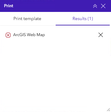

I am using ExB with Enterprise 11.1. I set up the print widget, but printing fails every time. In the print result box, I get a red X that just says "Error" if I hover over. Can anyone point me in the right direction to figuring out what's going on? I tried turning off all the layers, specific layers, different options for the layouts, etc.
Edit: Some updates after additional testing... I tried using the same data and adding the print widget in WAB and got an error that roughly said: convert WebMapToArcgisProject() takes 1 to 4 positional arguments but 5 were given. I tried the print widget in AGOL ExB and it appeared to work okay. Seems like this may be an issue with Enterprise. Anyone have any other suggestions for how to resolve this?
