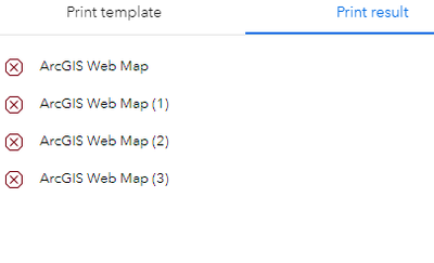

I am using ExB with Enterprise 11.1. I set up the print widget, but printing fails every time. In the print result box, I get a red X that just says "Error" if I hover over. Can anyone point me in the right direction to figuring out what's going on? I tried turning off all the layers, specific layers, different options for the layouts, etc.
Edit: Some updates after additional testing... I tried using the same data and adding the print widget in WAB and got an error that roughly said: convert WebMapToArcgisProject() takes 1 to 4 positional arguments but 5 were given. I tried the print widget in AGOL ExB and it appeared to work okay. Seems like this may be an issue with Enterprise. Anyone have any other suggestions for how to resolve this?

When I run into print issues like that. My usual suspects are as follows:
1. A basemap or service it doesn't like.  Swap basemap and layers
2. Clear out the print jobs folder in Server. Sometimes clearing it out fixes my issues.
3. Try swapping out print services
4. Check Dev Tools for any specific error messages that point at proxy issues.

Open up the Web Developer tools in your browser and switch it to the Network activity tab. Attempt to print and then examine what the response for the request is. That could help you narrow down if it's a specific layer in your map that's creating the issue. This was a problem for me in a Portal EB app I had (thread about it is here) and eventually we discovered that the group managed service account was not enabled in the Manage->Privileges within SDE for some layers. Once we corrected this, EB print would work as expected.

This is happening to us on all of our ExB apps and all of our Map Viewers also. I submitted a case to Esri. Here is the current status as of 1/9/25, 10 AM Mountain.;
"As discussed, we have noticed the issue, and our developers' team is working on getting it resolved. We will surely keep you updated on the progress of the issue through emails. "
