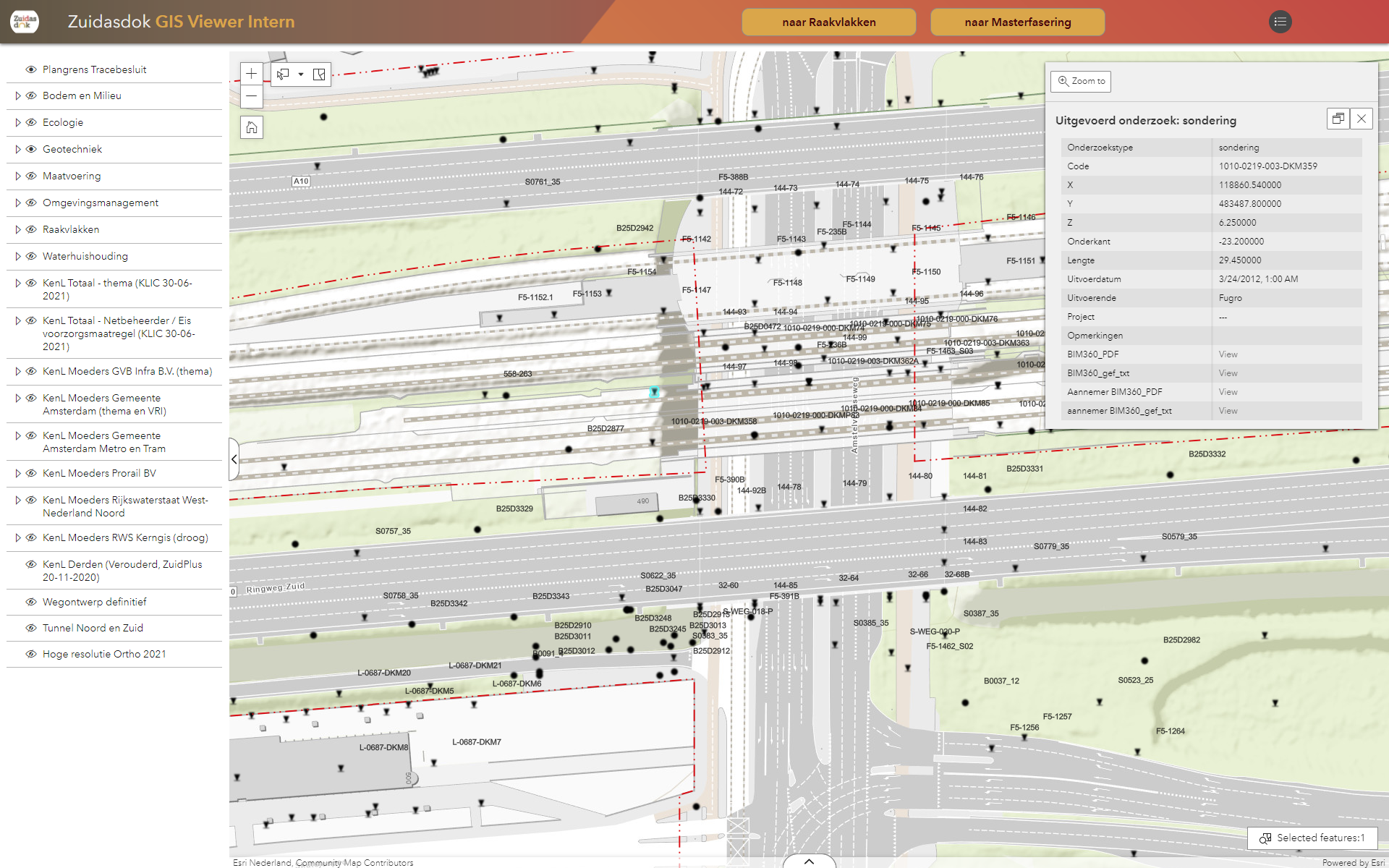

Unfortunately, it is not possible to create a web map application and maintain the group layers like in the new map viewer. Therefor, I made an app in Experience Builder. I think it works pretty well but the response time for a popup is very slow. In the map viewer it takes about 1-2 seconds but in EB app it takes about 15 seconds before the popup appears. Only one layer is visible.

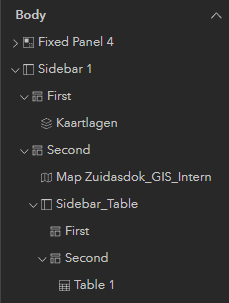

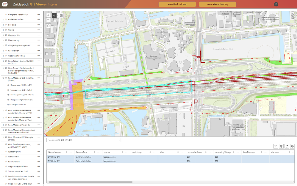

I used two sidebars. The sidebar below I used to show records from selected features in a table. I set this up comparable as with the select widget in a web map application.
When I removed the sidebar below, the popups appear as expected.

@Stefan_Thorn - the popup shows only when the feature on the map is clicked. The selection would not trigger the popup. To solve it, use the Feature Info widget, which is indeed a popup on the side panel, to show the content in the popup for selected features.
