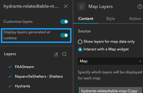

@JohnLucotch2 This behavior has been enhanced in the latest AGOL Feb 2025 release, with the following new option - "Display layers generated at runtime":
It is provided and turned on by default in the customize mode, and you can turn it off to keep the layers from being added to the widgets as you desire. Let us know if you encounter any issues on that.

TonghuiMing
