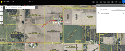

Does NOT seem to work yet.  If I draw a polyline and enable measurements, in the print, all I see is a point where the text should be.  I don't even see the polyline in the print.  See attached pdf produced from the print widget.  You can see the pinkish point on the map with no label for the measurement and no polyline symbol.  Here's what the map looks like:
