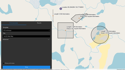

JasonMcKeefry
Can anyone confirm whether or not the text that gets placed on the map when measurements are turned on in the draw widget is showing up when using the print widget?  I cannot get the text on the map to also display on the map produced from the print widget.  It is removed from the resulting pdf or image from the print service.  Thanks.

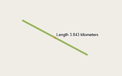

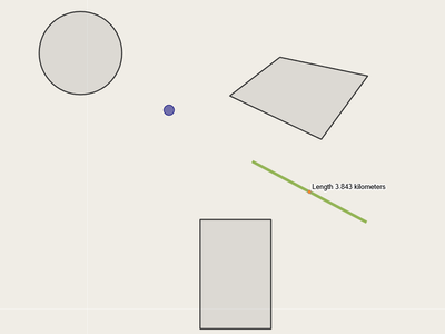

abureaux
MVP Frequent Contributor
Yep, text prints.
Using stock widgets. Just tossed them in to a new app to test.
abureaux
Actually, this is likely a bug. I just got lucky and picked the one feature that actually prints properly.
Lines work. Nothing else does.
JasonMcKeefry
...I get the text on the map, BUT NOT in the pdf or image that comes out of the Print Widget through an ArcGIS Server print service.  It doesn't look like that's what you tested.  Can you confirm that the text (even just for the line) shows up on the pdf or image that comes out of such a print service?  Thanks.
abureaux
My screen caps are from the PDF output. NOT the map. Yes, all text appears properly on the map.

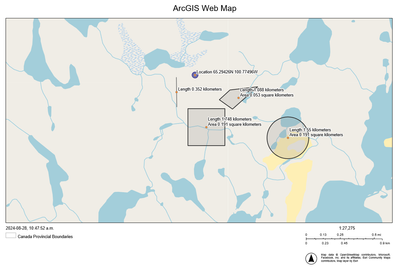

abureaux
Okay. Hold up... I was just grabbing some better screen caps to prove that was the PDF... and now it's working!
Map:
PDF:
This is obviously not working reliably right now... This is the same app. No changes since my last test where it didn't work.
