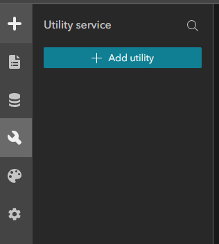

Sharing from Pro may require a certain permission/account level.   Several colleagues and myself ran into that blocker when trying to share these.
Setting up a custom print service to take advantage, also seems to be hidden behind a high level admin profile.

Configure utility services

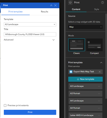

There is a default print widget, if you get the print utility into your experience, from the gear icon I think it is.  Then in your print widget you can set it up, and the templates there should appear after saving and preview/publishing it.
from the print widget... you can configure the tasks.
The key I believe is the ExportWebMap Task
