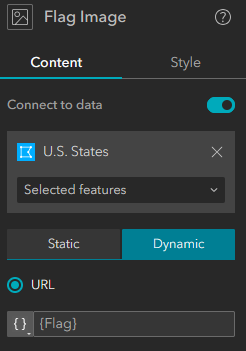

I am trying to add dynamic images based on a URL to my app. I have done this before and it worked marvelously, but it is not working now on a new Experience or with the older ones that were formally working.
The short version is this.
I add an image, connect to data, specify the data source, select Dynamic, and then select the field with the image URL. I also have view for empty selection set, etc.
It is not working and, I wish to repeat, it has worked in the past.
Is this a glitch with Experience Builder or has some subtle change been made since last I did this?

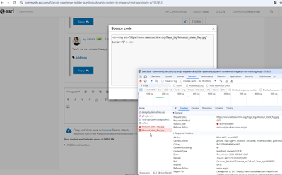

Our colleagues did a bit more testing - when we tried to put this URL into the community, it couldn't show either:
Which indicates the server hosting this image (www.nationsonline.org) has a CORS policy or recently added one, which caused the failure to fetch this specific image. You might want to double-check that. Thanks

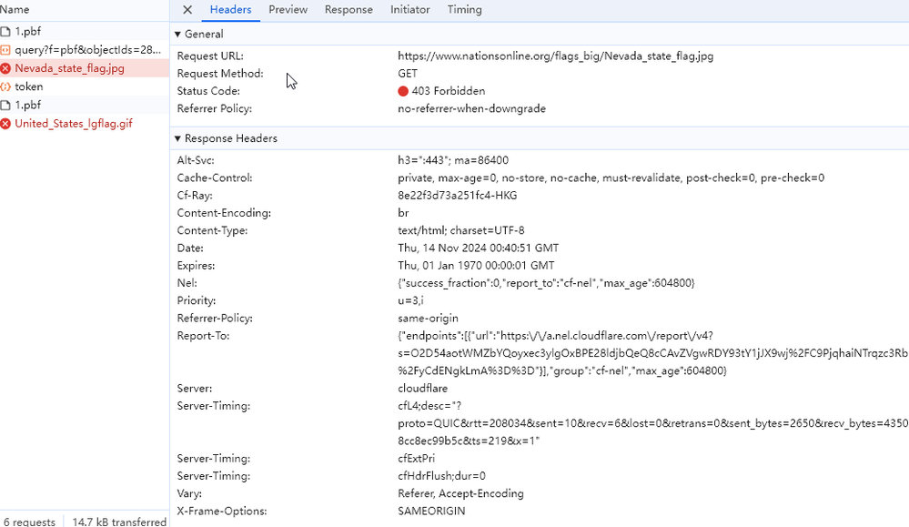

Well, this is very odd - I checked the configuration of your app, and the configuration looks okay. The URL is resolved, but the server returned a 403 error:
We are still trying to figure out what is happening.
