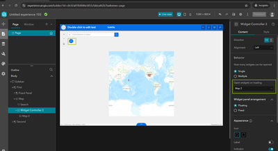

This problem seems easy to fix, but it actually has a certain degree of difficulty. It may involve reconstruction, and we will need some time. We will fix it as soon as possible.
Please track the BUG-000175526 Map widget configured as a child component to another Map widget disables panning & zooming.
Please try this workaround first.
1. Add a Widget Controller widget.
2. Add the Map widget in it.
3. In Widget Controller setting panel -> Open widgets on loading, select the map widget.
4. Turn on Preview and see.

I tried the work-around, all I got was a map widget symbol inside the widget controller.
Jim_Riedmann
Never mind, I need to revise this.  I tried it again, published it, and the map works as it should.  When I'm composing in Experience Builder the map inside the controller just shows the icon, but after I publish it and launch it the map appears and works perfectly.  When I try it in Live View it still just shows as an icon.
