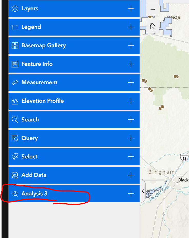

We really want to use the accordion to organize our ExB but we cannot find any way to get tools to open automatically like they do in a Widget Controller (and like in WAB).

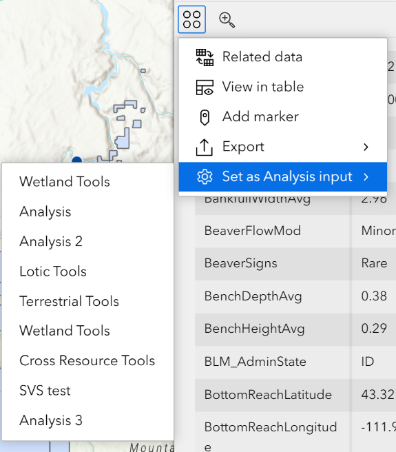

From the pop up

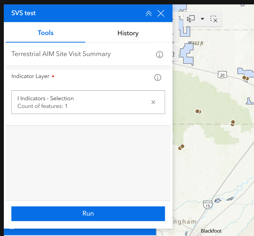

Tool pops open if its in a Widget Controller
Accordion it stays closed and the user is confused nothing happened.
Not seeing any actions except to just open the side bar.  Not seeing any actions off of Set as Analysis input also?
One idea is we add a widget controller and hide it from view but then that double lists all the tools and it opens up a new tool window not anything in the accordion.
Is there any controls for the accordion?  I like it but it seems limited in how it can interact with the map.

Hi @DougBrowning,
Thank you for pointing this out. ExB does not currently support this feature. We will look into this feature further to see if it can be enhanced.
