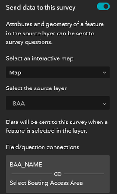

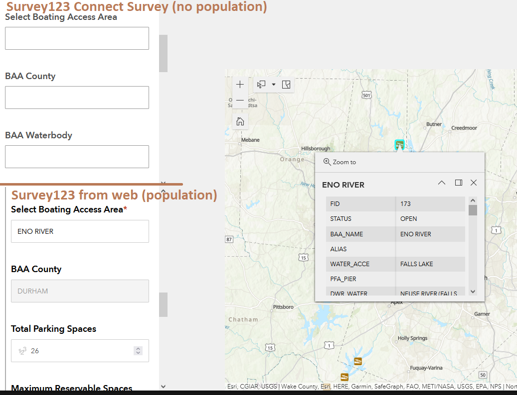

I am attempting to create a ExB app to function as a reservation system. Users would select a location on the map which would then populate a number of fields in the embedded survey using field/question connections. In testing with my survey built in Connect, the connection does not populate anything, but when trying the same field population to a dummy survey created through the online interface, the connection works as intended. Field types and restrictions are the same between both surveys.
Image for demonstration:

The survey is not built on an existing feature service. I'm just hoping to use the Send Data functionality with link fields within ExB to push a couple of fields from the map to the survey.

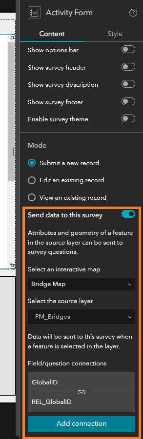

Is the "Send data to this survey" settings in Experience looking normal?  Were you able to add a data connection?  What does this screen look like?  This is from one of my experiences that sends to a survey built in Connect.

JohnLovette1
Yes, I believe I have all of that set up correctly.

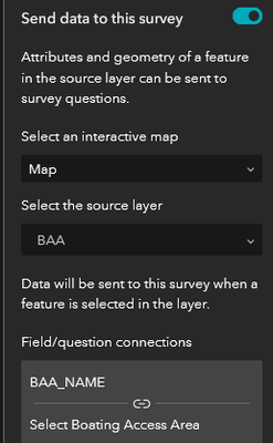

Here is the setup for the survey created in Surver123 web:
And here is the setup for the survey created in Connect...
Both set up exactly the same. Do you know if there are any under the hood features of surveys created in Connect that would prevent this link with the map from functioning properly?
