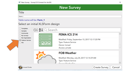

I am exploring how to integrate feature layers into Survey123 and would really appreciate any feedback on the following questions. I created a survey from an existing feature layer, with a point layer (rain gauges) that I want to collect data for, following these instructions. I could use clarification on:
1)  In Survey123 Connect > XLS form > Settings tab > submission_url  - Is this the URL for the feature layer created for the survey form in ArcGIS Online or is this the URL for the original feature layer in AGOL?

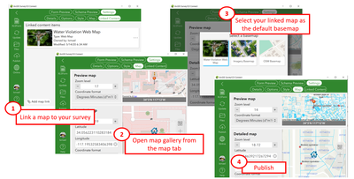

2)  Can I display the feature layer on the survey's map feature, such that people can select a particular rain gauge on the map and then answer the form for the feature? I thought that creating the survey from an existing feature layer would allow me to pull in the feature layer into the map; however, currently my survey map only displays an imagery basemap.

1) The submission URL will reference the original feature layer, assuming  you created a survey from an existing feature service using Survey123 Connect, this URL will reference the original feature layer.
Working with existing Feature Services in ArcGIS Survey123 (esri.com)
2) You can add custom layers/data for reference/viewing into your Survey123 basemap by linking map contents from your ArcGIS Online account. Please see the steps at the link: Survey123 Tricks of the Trade: Configuring survey ... - Esri Community
Source: https://community.esri.com/t5/arcgis-survey123-blog/survey123-tricks-of-the-trade-configuring-survey/ba-p/897815Source: https://community.esri.com/t5/arcgis-survey123-blog/survey123-tricks-of-the-trade-configuring-survey/ba-p/897815

2.  You can DISPLAY the existing feature layer in your basemap by adding the web map that contains it as "Linked Content" and then re publishing it (you have to publish the survey once before this becomes available).   You cannot interactive with the map though, it just acts as a basemap.
