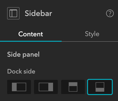

You can use a Sidebar widget to do that. Place the Table widget  in the dock of a Sidebar widget, and from the Sidebar widget settings panel you can set the Dock side to the bottom:

I would like to have table which can be hidden above map. So it does slide to above. So if you look at Jewelery box Exp builder template as the left information is sliding/ can be hidden. I would like to do exactly the same by putting table at the bottom of the page.
Shen_Zhang
