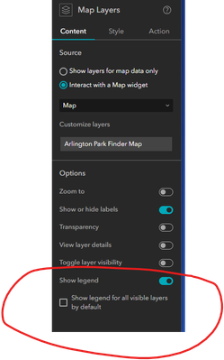

The Map Layers widget has the Show Legend option allowing it to operate as both the layer list and the legend. This option was introduced in Experience Builder 1.12, so it is not available in Enterprise versions older than 11.2.

Yes I did see that and I guess that will have to work. I'm not a fan of the layout like this however, maybe that's just me. It would be nice if there was still the option to have it look the way it is in the Layers tool on the map... I know many that don't even notice there's a scroll bar and need to continue to scroll to see more info. I'm all about making things as monkey proof as possible so I still see a not very tech savvy person having issues with this layout. But thank you for the response.
