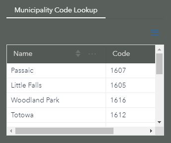

Is there a way to remove the blue button from the table widget? I disabled sheet tools, but there is still a tool, show/hide columns, that I cannot disable.
If not, can I change its color? I don't have blue as a theme color, so I don't know why this button is blue. I tried other preset themes, but this button is always in blue.

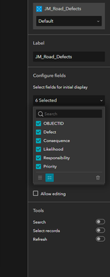

If it's to restrict the fields, make sure you have settings similar to;

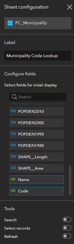

My setting is like this, but the "show/hide columns" is still enabled in the blue button.
I want to stop users using "show/hide columns". So if I cannot disable it, I'd like to change the color to hide it. I tried to change the fourth color, but it only changed the color of the map navigation icons, popup heading and table heading, not that icon I have in blue. I even tried to create a new Experience with only a Table widget, and that icon is still in blue.

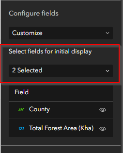

Hi @Boyang_Wang  @CoreyShamy149 @EricWeiner @JonathanMcDougall there is no way to hide the columns but you can hide fields that are not needed to toggle on/off for the table widget. Just use the "Select field for initial display" and make sure only the fields you want shown in the table are enabled. While I agree that the ability to hide this would be cool. It at least limits users to a point...! Hope this is helpful!
