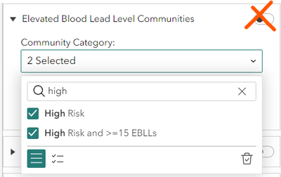

Has anyone else found when setting up a filter widget using the 'is any of' option in the expression builder on a text attribute producing a dropdown list of tick boxes,  that if you enter a search term in the little search box directly above the tick box list and select a tick box, it will remove the search filter despite the search term remaining in the box? I would expect the search filter list to remain in place whilst the search term is in the box.

Here's what I mean:
Image 1 - initial dropdown tick box list:
Image 2 - search term added, list filters by search term:
Image 3 - tick box selected, but the list 'unfilters' itself:

I just tested this in Enterprise 11.2, and I'm seeing the same thing, but only when the filter is turned on to start with. If I don't turn on the filter, it lets me keep checking boxes until I'm ready to turn it on.

Thanks @NicoleJohnson I hadn’t seen that so at least there’s  a workaround until the issue is ironed out.
