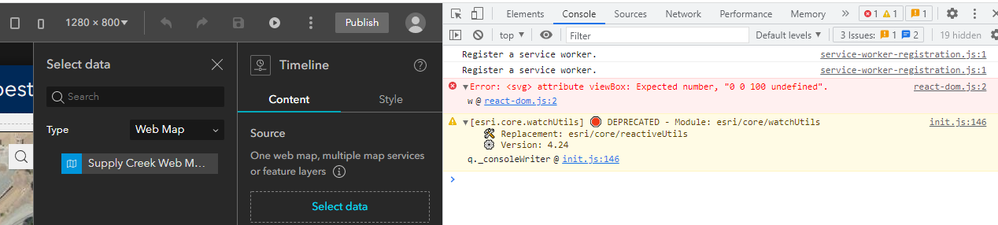

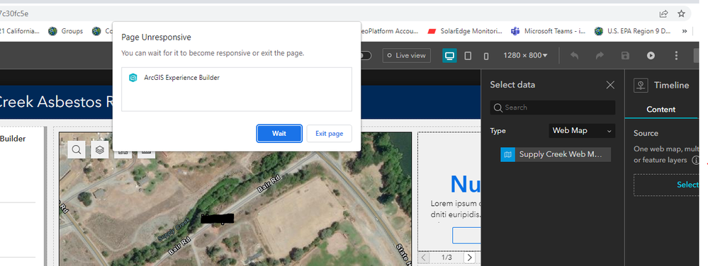

@TonghuiMing  When I go to select the data source, I see the pane open up but the page completely freezes and I cannot interact with it anymore.  Any ideas?  I've got ArcGIS Server services registered in AGOL, feature classes and layers in Web Map are time enabled.err.PNG

@SolanaFoo2 Based on your screenshots, it seems like the entire app or browser got jammed. It may not relate directly to the Timeline widget but rather more of a performance issue. Is it possible to share the app with me via DM to take a look at?
TonghuiMing
@SolanaFoo2 - The timeline widget frozen problem should be fixed in the latest AGOL 10.3 release. Thanks for the feedback.

@TonghuiMing Thank you for the follow up!  Sorry I didn't contact you, I didn't see a place for DMs and we ended up using a work-around (choosing individual layers).  This is great though, thanks!
