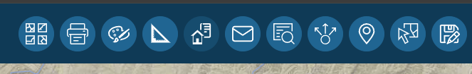

I am unable to increase the size of the widget icons on the widget controller. When I open the settings and change the size under appearance, it only increases the spacing between the widgets, not the size of the icons. I am currently using Developer Edition 1.15.

Set to small:
Set to large:

Thank you , it looks like this was introduced in the October '25 AGOL update / 1.19 DE update and I was able to implement it a few months back. I was able to get my widgets to match more closely to my header size.
